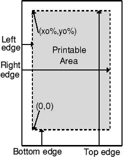

Referring to the diagram above right, consider the page to have one rectangle the size of the printable area; the bottom left coordinate must be the lowest most leftward printable location on the pag (0,0). All printers have differing margin sizes so how do we get the required data? Luckily, there is SWI "PDriver_PageSize" which returns the following: (Note the data starts at R1 not R0!)
R1 x size of paper (including margins)
R2 y size of paper (including margins)
R3 left edge of printable area
R4 bottom edge of printable area
R5 right edge of printable area
R6 top edge of printable area
All these measurements are in units called millipoints (see later).
Using this data, we can determine the size and position of the printable area. Once this is done, all graphic plotting has an origin relative to the bottom left corner of this rectangle. This or gin is not the same as the origin used in window drawing (usually top left), so I plot from an origin at top left by defining xo% as left margin position (in OS units!) and yo% as the top e ge. This means the same code can be used for printing as well as window drawing.
There is just one problem in all this - the units. The page size and 'plot at' data are in millipoints whereas the dimensions of the rectangle are in OS units. Luckily, 400 millipoints = 1 OS unit, s conversion is easy. The relevant code to do all this is in PROCprintwindow, the main lines being:
SYS"PDriver_PageSize" TO ,xpg%,ypg%, ledg%,bedg%,redg%,tedg%
rect%!0=0:rect%!4=0:rect%!8=(redg%-ledg%)DIV400:rect%!12=(tedg% bedg%)DIV400
plotat%!0=ledg%+8:plotat%!4=bedg%+8
trans%!0=1<<16:trans%!4=0
trans%!8=0:trans%!12=1<<16
xo%=4:yo%=(tedg%-bedg%)DIV400-4
REM xo%,yo% top left of rectangle
REM to plot as per window drawing.
Note: The actual 'plot at' position and the (xo%,yo%) origin are moved slightly into the rectangle. This is to allow for some printers clipping the edges of the printout.
