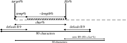

In the diagram below, the dashed line represents a paragraph of text held in memory, with the found string shown near the start of the paragraph by 'xxxxx'. The register target% is currently pointing at the start of the paragraph; file% points at the end of the found string, char% holds the total distance between these two points, and temp% now holds the distance between the start of the paragraph and the start of the found string. As the diagram attempts to make clear, the default value calculated for R9 is such that, after adding this value to both ends of the found string, the length of the extract will be 80 characters.
The diagram illustrates the case when the found string is so close to the start of the paragraph (the dashed line) that there is no room to add R9 characters at the beginning, i.e. when temp% < R9. At the bottom is shown the new value of R9 necessary to be added at the end if a length of 80 characters starting from target% is still to be obtained; it should be evident from the diagram that this value is given by (80-char%).
