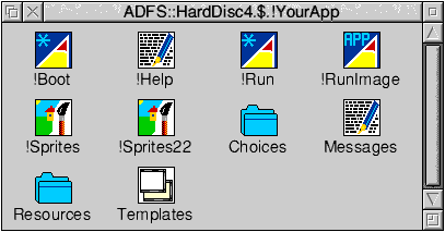

Open any application directory and you will probably find a fairly similar set of files/folders. This screenshot is typical:
These files/directories hold various 'resources' needed to allow the application to operate as intended. Typically, some of the following files/directories will be present: !Run, !Boot, !RunImage, !Sprites, !Sprites22, Templates, Modules, Fonts, Messages, !Help, but there may be others instead or in addition.
The reason why most applications use the same sort of structure for these resources is that RISC OS has in-built management arrangements which offer considerable advantages to the programmer if the resources conform to recommended practices - and the Acorn Style Guide contains the details.
