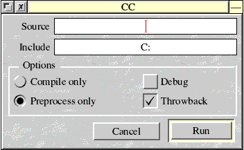

The preprocessor is a very handy part of the C language. It has a number of functions which you may have already seen if you've selected the Preprocess only icon in the Acorn C front-end program. What this does is to run through all the files that you've #include-d in your main source code, inserting the parts of the included file which are needed.
If the parts aren't there, the preprocessor tells you in the throwback screen.
