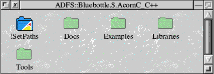

OK, enough of this waffle and on with the show. I've assumed that you will have installed Acorn C and have a directory looking something like this:
You should now create a directory called (something like) Learning. Inside this, you will need to create the following directories : c, compiled, files, h and o. The text files are saved into the c directory and the compiled apps into the compiled directory.
