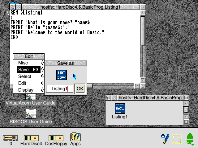

Now to type in Listing 1. Load Edit onto the iconbar, and press Menu over the icon. Move into the Create submenu and click on Basic; this opens up a normal Edit window, but ensures that what you are creating is a Basic program, rather than a straight text file. Get used to this window: you'll be seeing a lot of it.
Typing in the program is a breeze. Simply type each line as it is listed, and press RETURN at the end of each line.
When you've finished typing in the program, save it just as you would save a text file, by pressing F3 or using the Save option from the menu. That's all there is to it; you've created a Basic program.

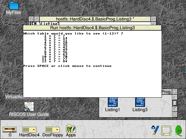

You can run your program by double-clicking on your Basic file. Hopefully a little screen will appear with a prompt for you to enter your name: do so and press RETURN. The program displays a friendly greeting, and a message appears inviting you to press the space bar, or click a mouse button. This is what happens with programs that do not multi-task: they take over the machine until they have finished executing, then you have to click the mouse to return to the desktop. The programs in this series will not be multi-tasking desktop applications: the theory behind writing multi-tasking programs is complex and books on the subject require prior knowledge of Basic programming.

Listing 3 is a slightly longer program with lots more commands to bemuse and amuse. Type it in and run it to display multiplication tables: hardly mind-bending, but not bad for the end of the first article, surely?
Listing 3 |
REM >Listing3 : ON ERROR REPORT:PRINT " at line ";ERL/10:END REPEAT INPUT "Which table would you like to see (1-12)? "table% UNTIL table%>=1 AND table%<=12 FOR loop%=1 TO 12 PRINT loop%;" x ";table%;" = ";loop%*table% NEXT loop% END |
